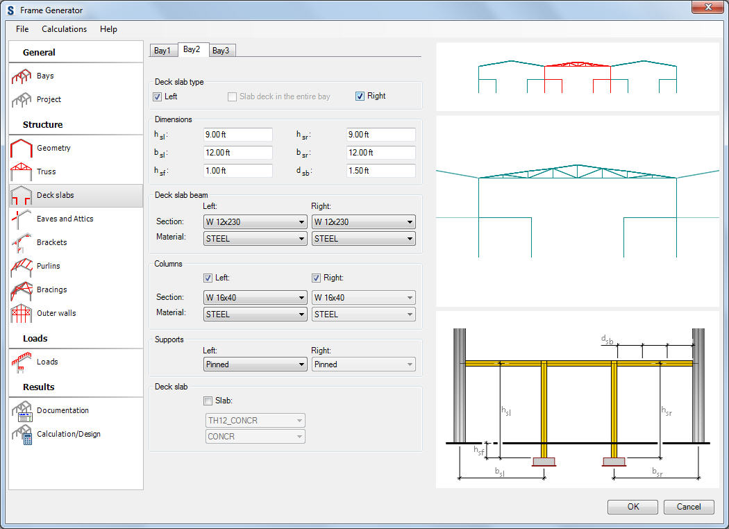

Deck slabs
Use the options on this tab to define the basic information on the geometry of the deck slabs.
Data to define deck slabs for a selected bay:
  1. deck slab can be defined:
    from the right and/or left side
    for the entire bay
  2. dimensions of deck slab
  3. parameters for the deck slab beams and columns (sections and materials); the columns can be defined optionally
  4. support type for columns under the deck slab
  5. there is a possibility to define thickness of the slab and the material slab in the bottom part of the dialog If you turn off the Slab option, the cladding transferring the defined load is generated.
Select the More... option in the selection list of profiles, supports or the slab thickness to open an additional dialog where you can add another profile from the selected profile database to the list of the available profiles; you can also define the structure support by creating a new support.
