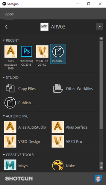

To begin working in VRED using the Shotgun integration, once you've signed into Shotgun, in the Automotive section of Shotgun Desktop, click the VRED icon. This will launch VRED through Shotgun.
If you've already used VRED with Shotgun, an VRED icon also appears in the Recent section.

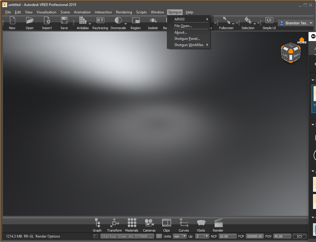

When VRED opens, a Shotgun menu (the VRED engine) is added to the menu bar.
Use the Shotgun menu (also referred to as the VRED integration engine) to access a default set of apps.
Use this default set of apps for opening and saving files, publishing work, and getting Shotgun information through the Shotgun Panel. Once a file is modified (opened or saved) and the context of the scene is set, more apps will appear under the Shotgun menu.
When you first access the Shotgun menu, the top entry in the Shotgun menu will be your current project. Select it to access these default apps:

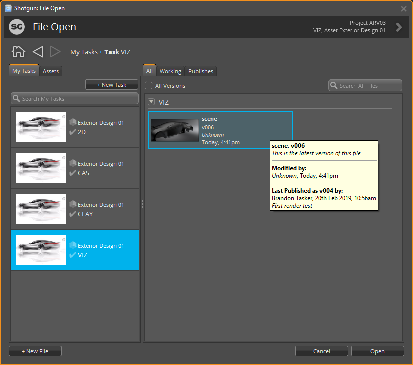

File Open: Opens the File Open Shotgun dialog, where you can search for and select working files sorted by the Tasks you are assigned. Use it to open and manage all your daily working files.
Once you've used File Open, the top menu entry changes to a Shotgun contextual name, plus project name. Shotgun looks at the current thing you're working on, such as a task or asset to create the contextual name, then appends it with the project name.

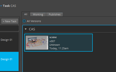

Use the My Tasks and Assets tabs to see all your assigned tasks and browse for assets. To the right, use these tabs to view all files, working or published files associated with what is selected to the left.
Use the All Versions box to access previous versions of files.
This displays all versions of the selected asset or task. Right-click a file to access options for:
opening the file
continuing work on a file
open a file from the Publish Area
continuing work from the Publish Area
accessing a previous version and doing any of the above
creating a file
accessing the file system
showing the published version in the file system or Shotgun
When finished, click Open to open the file in the engine's application.
About: Opens the Shotgun About box that lists attributes for third-party libraries used in Shotgun.
Shotgun Panel: Opens the Shotgun Panel, which is a small and lightweight window for accessing all information stored in Shotgun related to your current project, without ever leaving the application you’re working in. Easily access task information, the activity stream, notes, tasks, versions, and published files from Shotgun. Review versions sent by teammates, reply to notes, create new tasks, and search the Shotgun site.
Shotgun Workfiles: Contains two options: File Open and File Save.

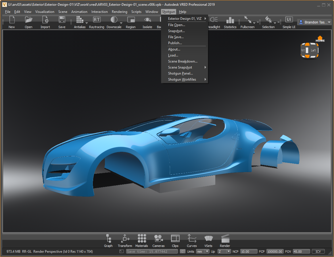

As mentioned above, once the context of your scene has been set (by opening or saving a scene), more apps appear under the engine, such as:

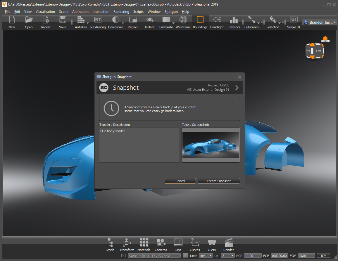

Snapshot: Opens the Snapshot dialog to create a quick backup of the current scene. Enter a description, click inside the Take a Snapshot area, then click the Create Snapshot button. Once the snapshot is created, a Success! message should appear. Either view your snapshot history or click Close.

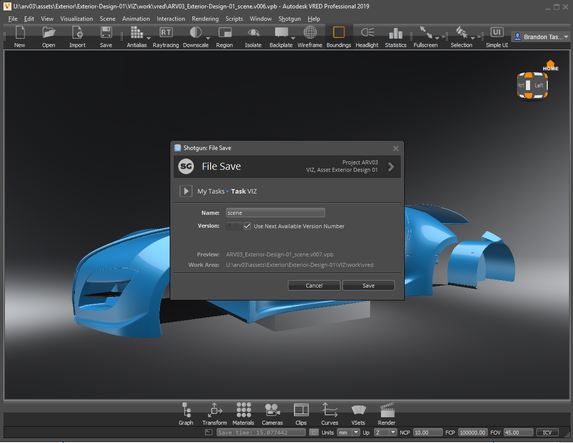

File Save: (Same as the Shotgun > File Save app) Opens the File Save dialog to name the file, version it, then save it, updating the Shotgun linked information.

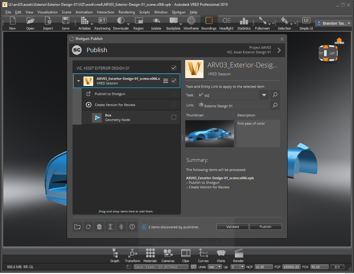

Publish: Opens the Publish dialog for publishing the file to Shotgun, which can then be used by artists downstream. For more information, see The Publisher.

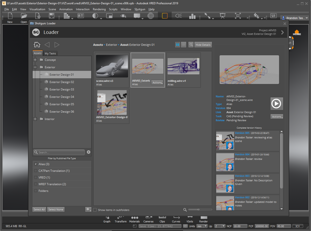

Load: Opens the Content Loader app, along with instructional slides explaining how it works. For more information, see The Loader.

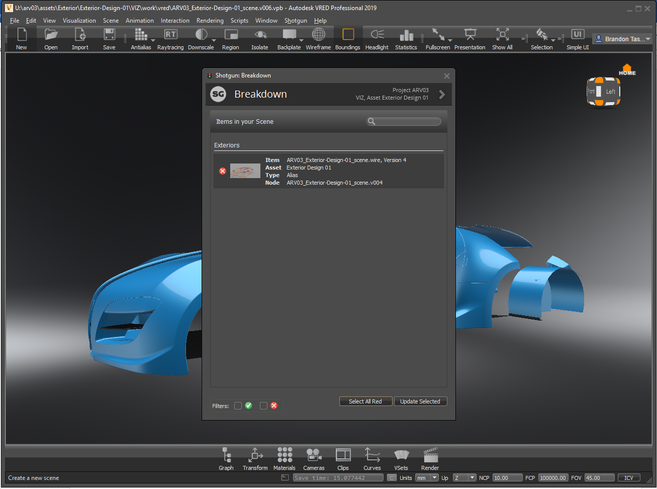

Scene Breakdown: Opens the Breakdown dialog, which displays a list of referenced (WREF References) content, along with what in the scene is out-of-date. Select one or more items and click Update Selected to switch and use the latest version of the content. For more information, see Scene Breakdown.
Scene Snapshot: Contains the following apps:
Snapshot: (Same as the Snapshot app mentioned above) Opens the Snapshot dialog to create a quick backup of the current scene. Enter a description, click inside the Take a Snapshot area, then click the Create Snapshot button. Once the snapshot is created, a Success! message should appear. Either view your snapshot history or click Close.
Snapshot History: Opens the Snapshot History dialog to view a list of all snapshots of the current open file. To return to a previous version, select it, then click Restore. To create a snapshot, click New Snapshot. When finished, click Close.
Another way to access the Snapshot History app is to click the View Snapshot History button from the Snapshot dialog.
