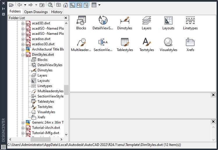

Design Center
Use Design Center if you want to import multiple dimension styles from another drawing or drawing template.
  1. Click View tab > Palettes panel > DesignCenter. Find
  2. On the DesignCenter toolbar, click Load.
  3. Navigate to the drawing, or drawing template, that contains the dimension styles you want to import and click Open.
  4. Double-click Dimstyles on the right pane to display the individual dimension styles.
  5. Select the dimension styles you want to import. Multiple dimension styles can be selected by holding down the Shift or Ctrl key while selecting.
  6. Right-click and select Add Dimstyle(s).
    The dimension styles are added to the current drawing.
  7. Note: Dimension styles that already exist in the current drawing are not imported or updated.
