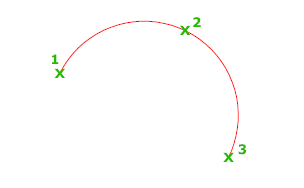

Start point
Draws an arc using three specified points on the arc's circumference. The first point is the start point (1).
Second point
Specify the second point (2) is a point on the circumference of the arc.
End point
Specify the final point (3) on the arc.
You can specify a three-point arc either clockwise or counterclockwise.

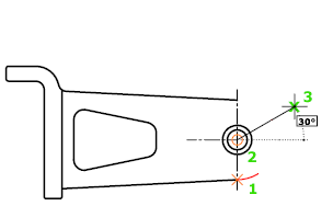

Center
Specify the second point (2) is the center of the circle of which the arc is a part.
End point
Using the center point (2), draws an arc counterclockwise from the start point (1) to an endpoint that falls on an imaginary ray drawn from the center point through the third point (3).
The arc does not necessarily pass through this third point, as shown in the illustration.
The distance between the start point and the center determines the radius. The endpoint is determined by a line from the center that passes through the third point.

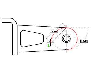

Angle
The distance between the start point and the center determines the radius. The other end of the arc is determined by specifying an included angle that uses the center of the arc as the vertex.
If the angle is negative, a clockwise arc is drawn.
