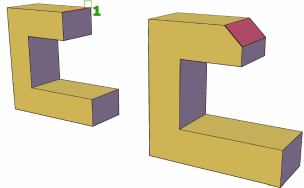

Summary
You can select more than one edge at a time, as long as they belong to the same face. Enter a value for the chamfer distance or click and drag the chamfer grips.
