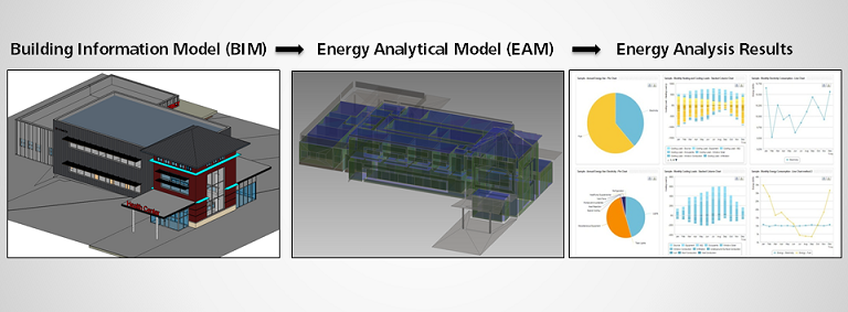

Autodesk Green Building Studio uses the DOE2 simulation engine and is web-based software that enables architects and designers to perform whole-building analysis, optimize energy consumption, and work toward carbon-neutral building designs earlier in the process. Green Building Studio powers the energy analysis tools in Revit and Vasari, and is available to Autodesk Subscription customers.
The most effective decisions for sustainable design can be made in the early design phases. Autodesk whole building energy simulation tools are built to help you to create energy models in the early design stage to make informed design decisions.
The following chart shows how these tools are integrated:

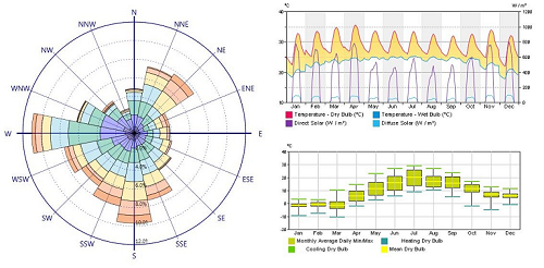

Climate Analysis

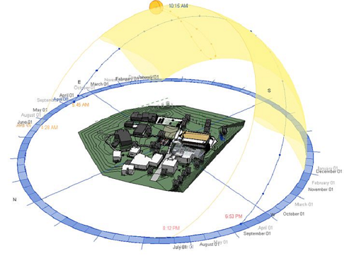

Sun and Shadow Studies
In Revit
In Vasari

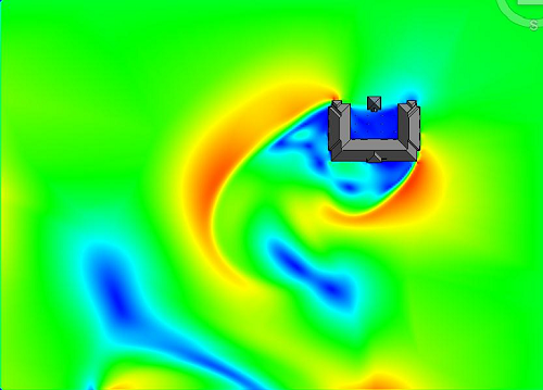

Conceptual CFD Analysis
In Revit
