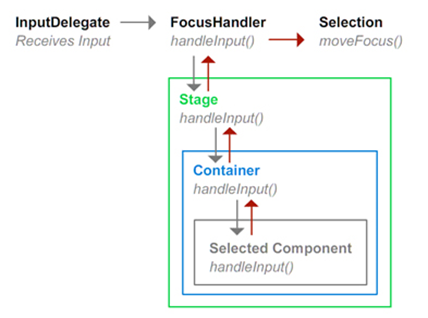

The FocusHandler listens for InputEvents dispatched from InputDelegate and then re-dispatches the same InputEvent from the currently focused component to be handled by that component or another component in the event’s bubble chain. The focused component is used to determine the focus path, which is a top-down list of components in the display-list hierarchy that implement the handleInput() method.
Figure 62: The handleInput() chain.
When the InputEvent has been handled, the handled property should be set to true. This allows for other components who receive the event to check event.isDefaultPrevented() to discern whether the event has already been handled.
