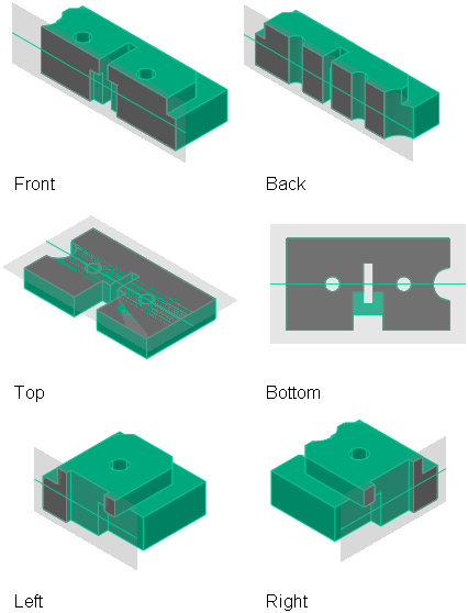

- Align section to. Sets the position of the section object to align with one of the following UCS orientations that you specify:
- Front
- Back
- Top
- Bottom
- Left
- Right
