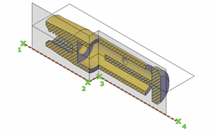

SECTIONPLANEJOG (Command)
Adds a jogged segment to a section object.
Find
You can insert a jog, or angle, into a section object as you create it. The jog is created on the section line. The jogged segment is created at a 90-degree angle to the section line.
Note: The SECTIONPLANEJOG command was previously named JOGSECTION.
The following prompts are displayed.
Select section object
Specifies which section line to modify.
Point on the section line to add jog
Specifies the location of the jog.
