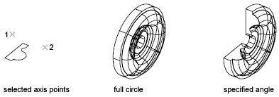

Axis Start Point
Specifies the first point of the axis of revolution. The positive axis direction is from the first to the second point.
Axis Endpoint
Sets the endpoint for the axis of revolution.

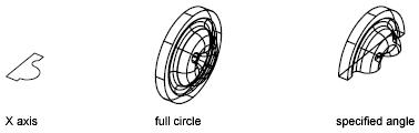

X (Axis)
Sets the positive X axis of the current UCS as the positive axis direction.
