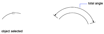

Angle
Changes the included angle of the selected arc by the specified angle.

Total
Sets the length of a selected object by specifying the total absolute length from the fixed endpoint. Total also sets the included angle of a selected arc by a specified total angle.
Total Length
Lengthens the object to the specified value from the endpoint that is closest to the selection point.
Angle
Sets the included angle of the selected arc.
