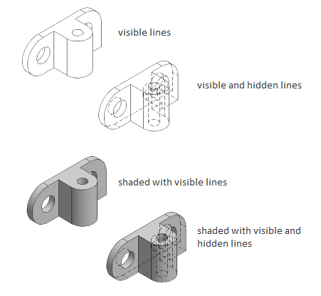

Hidden Lines
Specifies the display options for the section view.
Visible Lines
Displays the section view in wireframe with only visible lines showing.
Visible and Hidden Lines
Displays the section view in wireframe with both the visible and hidden lines showing.
Shaded with Visible Lines
Displays the section view as shaded, with only visible lines showing.
Shaded with Visible and Hidden Lines
Displays the section view as shaded, with both visible and hidden lines showing.
