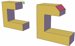

Bevels the edges of 3D solids and surfaces.
Find
You can select more than one edge at a time, as long as they belong to the same face. Enter a value for the chamfer distance or click and drag the chamfer grips.
Select an Edge
Selects a single solid or surface edge to chamfer.
Distance 1
Sets the distance of the first chamfer edge from the selected edge. The default value is 1.
Distance 2
Sets the distance of the second chamfer edge from the selected edge. The default value is 1.
Loop
Chamfers all edges on a single face. For any edge, there are two possible loops. After selecting a loop edge you are prompted to Accept the current selection or choose the Next loop.
Expression
Controls the chamfer distance with a mathematical expression. See Control Geometry with the Parameters Manager for a list of operators and functions allowed.
