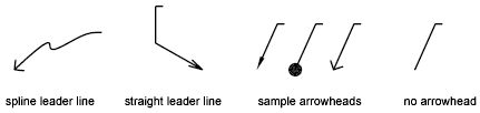

Controls the way the leader is drawn and whether it has an arrowhead.
Spline
Draws the leader line as a spline. The vertices of the leader line are the control points, each of equal unit weight.
Straight
Draws the leader line as a set of straight line segments.
Arrow
Draws an arrowhead at the start point of the leader line.
None
Draws a leader line with no arrowhead at the start point.
