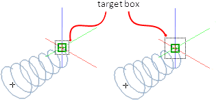

Controls the size of the object snap target box.
Object snaps become active when the object snap target box passes over an object location such as an intersection or endpoint. Depending on the complexity of your drawing, you can increase or decrease the area that is influenced by object snaps.

Object snap target height
Sets the height of the object snap target box in pixels. The higher the number, the larger the target box.
