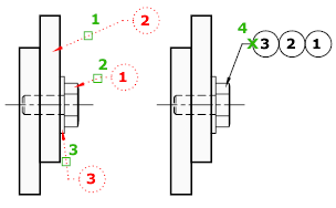

Organizes selected multileaders that contain blocks into rows or columns, and displays the result with a single leader.
Find
After you select multileaders, you can specify their placement.
For example:
The following prompts are displayed.
Specify collected multileader location
Specifies the point for placing the multileader collection in the upper-left corner of the collection.
Vertical
Places the multileader collection in one or more columns.
Horizontal
Places the multileader collection in one or more rows.
Wrap
Specifies a width for a wrapped multileader collection.
  • Specify wrap width.
  • Number. Specifies a maximum number of blocks per row in the multileader collection.
