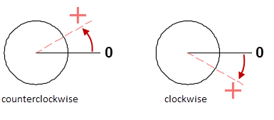

Measure angles clockwise?
Specifies the direction of positive angles from angle 0.
