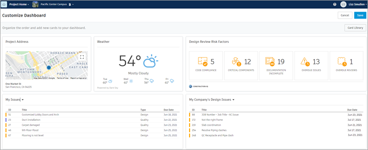

Project Home
Project Home is your BIM 360 landing page and dashboard which displays a single view of your project.
The dashboard uses cards to access:
  • Important, relevant, and actionable information from the BIM 360 modules.
  • Other third-party services leveraged in the project.
You can quickly evaluate areas that require the attention of you or your team, and easily navigate to the other modules to continue your work.
Card Settings and Configurations
The card information presented on the dashboard depends on your project module access and the permissions associated with your assigned role. For more information, see Visual Workflow: Get Started with Insight.
At a high level:
  • Project members: View issues directly relevant to you. It will help you answer the question, "What do I need to do today?"
  • Project managers, or administrators: View details that help you understand the most pressing needs for the day, as well as outstanding items at the project level.
Add, Remove and Manage Cards
You can add, remove, or rearrange cards in Project Home and the Insight tabs. For more information and instructions, see Customize Dashboards.
View and Edit Settings
Click on a card to view when the data was last updated. For some cards you can also edit settings, such as the units the data is displayed in, or hide the card to remove it from the dashboard.
Expand and Collapse
Click to expand a card to full screen view. When complete, collapse the card to the original size.
