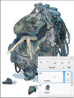

Normal
Example of Normal blend mode in SketchBook
Removes any color correction applied to the layer. The layer appears exactly as it was created.

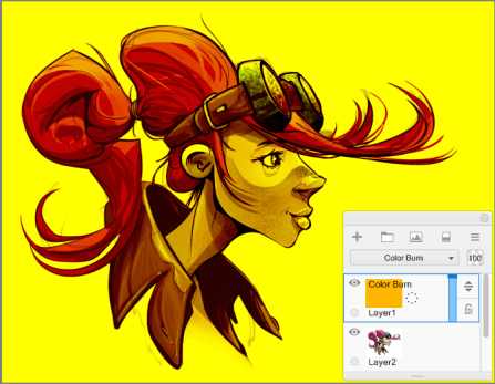

Color Burn
Example of Color Burn in SketchBook
Enhances the contrast by applying the colors of the blended layer and base. The intensity of the tones in the blended layer determines the degree of color change:
  • darker colors create a more intense effect.
  • white areas remain the same.

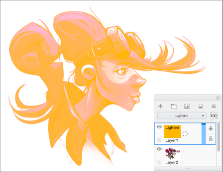

Lighten
Example of Lighten in SketchBook
The opposite of Darken. Takes two layers (the blended layer and the base), compares their pixels, and displays the lighter of the two.

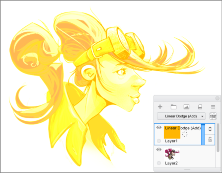

Linear Dodge (Add)
Example of Linear Dodge in SketchBook
Lightens the overall composition, similar to Screen, but more dramatically. Each pixel is brightened by a value equal to or lesser than the value of pixels on other layers occupying the same location in the layer stack. This is applied as a linear calculation.

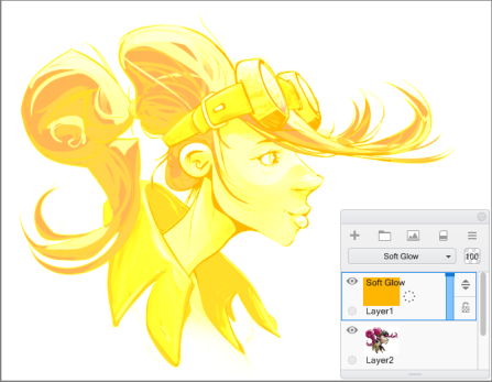

Soft Glow
Example of Soft Glow in SketchBook
Softens or blurs the color and intensity of Glow, like the light emanating from a translucent object.

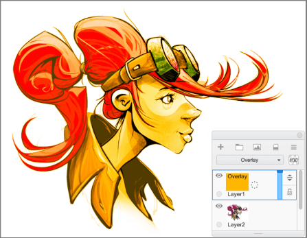

Overlay
Example of Overlay in SketchBook
A mix of Multiply and Screen. Takes dark values and multiplies them and screening light values from the base layer. Brightness is unchanged, so it tends to look harsher than Soft Light.

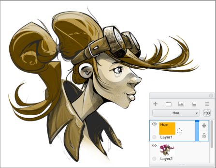

Hue
Example of Hue in SketchBook
Takes the hue of the blended layer, changing that of the base layer, without affecting the brightness or saturation levels.

How to change your image to black and white
If you are looking for a way to change your images to black and white, use the Hue blend mode to achieve this. You will need to make a copy of the file and merge the layers.
