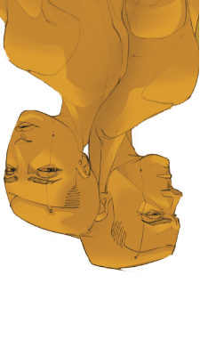

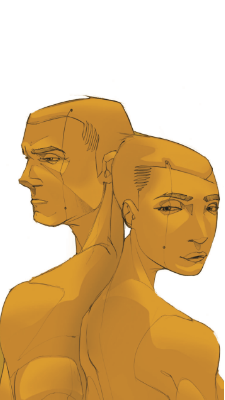

Flip or mirror your canvas
To flip the canvas vertically, select Image > Flip Canvas Vertically.
flip the canvas vertically 1flip the canvas vertically 2

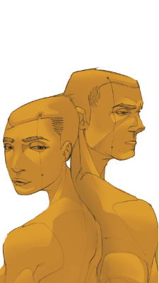

To flip the canvas horizontally, select Image > Mirror Canvas.
flip the canvas horizontally1 flip the canvas horizontally
