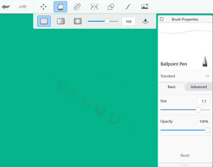

Using Flood Fill in SketchBook on Windows 10
Flood Fill toolbar in SketchBook Pro Mobile
Filling an area on Windows 10
  1. Tap Fill icon Fill.
  2. Select a fill: Solid fill icon Linear fill icon Radial fill icon
    Note:
    For information on Linear or Radial, see Using a gradient fill.
  3. Tap an area to fill it.
    Note:
    Fill manipulators can be added, moved, or removed. See Using a gradient fill for details. To change the color of the paint, tap the Color Puck, then the area you want to fill. You are still in the Fill tool.
  4. Tap Confirm to accept or Cancel to decline the fill.

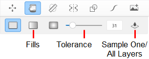

Changing fill tolerances on Windows 10
  1. Select the region to fill.
  2. In the Fill toolbar, tap-drag the slider to change fill tolerances. As you make changes, the fill automatically updates, making it easy to get it just right.
    Fill tolerance at 26 Filling a shoe when the fill tolerance is set to 130

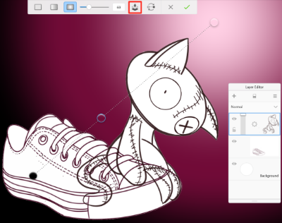

Creating a gradient fill
  1. Create an area to be filled.
  2. With the Fill SketchBook's Fill icon tool selected, select a Gradient Fill (SketchBook's Linear Fill icon or SketchBook's Radial Fill icon) from the Fill toolbar.
    Fill Toolbar
  3. Click-drag to place the fill.
    Radial Gradient Fill - showing direction of manipulators
Editing a gradient fill
As long as the manipulators are displayed, you can edit your fill. There are many ways to edit a gradient fill. Do either of the following:
  • To change the color of a manipulator, tap the manipulator and select another color from the Color Puck
  • To move fill manipulators, tap-drag a manipulator into position.
  • To add a manipulator, tap anywhere along the line between manipulators.
  • To delete a manipulator, tap-drag the manipulator away from the fill line.
  • To change the tolerances of a fill, in the Fill toolbar, tap-drag the Tolerance slider. Increase the tolerance to increase the range of colored pixels affected by the fill. Decrease the fill to reduce this.
  • To sample one or all layers, tap Sample All OFF or Sample All ON.
    What is Sampled Fill Outcome
    Sample One LayerSample One Layer Radial Gradient Fill with Sample One Layer
    Sample All LayersSample All Layers Radial Gradient Fill - Sample All Layers
Reversing the direction of a fill
Once your fill is created, in the Fill toolbar, click Reverse fill to reverse the order of the fill manipulators.
Fill gradient direction 1 Fill gradient direction reversed
