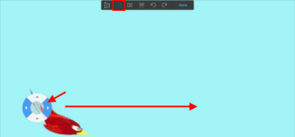

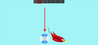

Moving content
Drag with your finger to move the content of a layer or tap Nudge icon.
  1. Tap Transform icon in the mobile version of Autodesk SketchBook and select Nudge icon.
  2. Tap-drag one of the arrows to move the content on that layer along the axis selected.
    • If you select either arrow along the sides, your movement is constrained to left and right.
      Move - tag-drag on an arrow and drag in that direction. Move - constrained along one axis.
    • If you select either arrow at the top or bottom of the puck, your movement is constrained to up and down.
      Move - tag-drag to move up or down. Move - motion is constrained to only up and down.
    • If you tap-drag within the middle of the puck, you can move in any direction.
