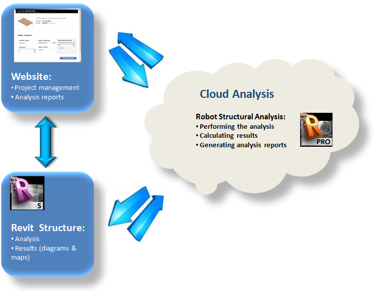

Autodesk® 360 Structural Analysis for Autodesk® Revit® software referred to as Structural Analysis for Autodesk Revit lets you perform cloud-based structural analysis of a Revit Structure analytical model. Results are displayed in the Revit project and can be further explored.
To prepare Revit analytical models for analysis, you need to install the Structural Analysis for Autodesk Revit add-in on the computer with Revit installed. After a model has been prepared, you can also submit the analysis on the Structural Analysis for Autodesk Revit website (see: Using the Website).
The Structural Analysis for Autodesk Revit add-in uses the Autodesk® Robot™ Structural Analysis Professional engine.
Autodesk® Robot™ Structural Analysis Professional is integrated graphic software for modeling, analyzing and designing various types of structures. You can use it to create structures, perform the structural analysis, and verify results.
Architecture of Structural Analysis for Autodesk Revit: Workflow
