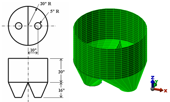

Construct the 3-D hopper as shown in the following image.
Draw half of the model using structured meshes.
Use the mirror command to complete the model by creating the other half.
