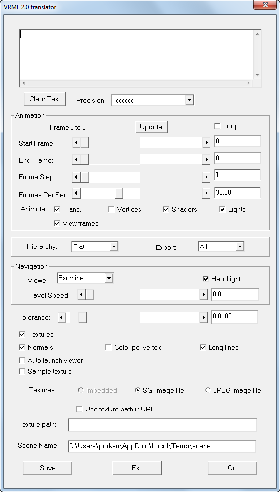

VRML2.0 translator additional options
This window appears when you select Go from the options window described above. Alternatively, you can access it directly by selecting File > Export > VRML2.0 .
After you have used this window to set translation options, click its Go button to start converting.
The translator creates a file (<scene>.wrl) containing VRML code describing the scene.
Push buttons
Save
Saves the current settings in the window.
Go
Starts the conversion.
During conversion, this button changes to Abort. Click it again to stop the conversion.
Exit
Closes the translator window.
Text section
This section appears at the top of the window. Type a comment for saving with the scene. To clear its contents, click Clear text.
Animation section
The text at the top of this section indicates the animation frames available for export. If you add frames while this window is open, this number will no longer be accurate. (Click Update to update the frame count.)
Start Frame and End Frame
Specify the start frame and end frame of the animation you want to convert.
Frame step
Defines the number of animated frames between exported frames.
Frames per sec
Specifies the playback speed of the converted animation.
Animate
Lets you choose what to animate. Select one or more of transformations, vertices, shaders, and lights.
View frames
When checked, lets you view animation frames in the Alias view windows while you export them.
Hierarchy section
Hierarchy
World – Do not export hierarchy (all vertices use world space)
Flat – One level of hierarchy: transformations use world space, vertices use local space
Full – Export the full DAG tree hierarchy: transformations and vertices use local space
Export
All – Export everything visible in the scene
Picked – Export everything picked in the scene (items lower in the DAG tree from the DAG nodes of picked objects are not included).
Active – Export everything picked in the scene (items lower in the DAG tree from their DAG nodes of picked objects are also included).
Navigation section
These settings control the initial set-up of the VRML browser when it opens the .wrl file:
Viewer
The initial type of navigation.
Headlight
When ON, the viewer will cast light on the scene.
Travel speed
The initial speed of the viewer.
Other options
Textures
Export textures.
Normals
Export normals.
Color per vertex
ON – Calculate color for each vertex.
OFF – Calculate color for each polygon.
Long Lines
ON – Save the VRML text file with long lines.
OFF – Break the VRML text file into short lines (each value on a separate line).
Turn this option OFF if you want to edit the output file with a text editor that does not handle lines longer than 80 characters well (such as vi). This will increase the size of the output file.
Auto launch viewer
When ON, opens the new VRML file in Netscape Navigator after export.
To view VRML files in Netscape Navigator, you must have the Navigator VRML plug-in installed.
Sample Textures
Converts procedural textures to image files.
Textures
Imbedded – Includes texture image data in the .wrl file (not currently supported).
SGI image file – Converts texture images to SGI format and reference.
Use texture path in URL
Includes the texture path in the URL of the .wrl file.
Texture path
Save textures to this folder.
Output section
Scene name
Base name for the scene, to which the translator will add the suffix .wrl.
