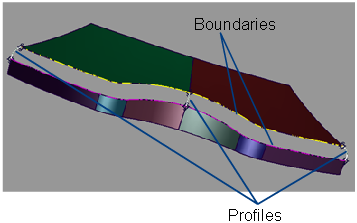

You can place any number of profile curves (cross-sections) at any point between the primary surfaces’ boundaries. Profiles can be any type of curves, including blend curves and surface boundaries.

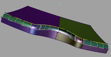

The first set of boundaries is highlighted in purple, and the second set of boundaries is highlighted in yellow.
If Chain Select is turned on in the option window, selecting the boundary of one surface will also select all other boundaries that are tangent continuous with it.
The selected profile curves are highlighted in white.
After you select the first profile curve, an Update button appears.

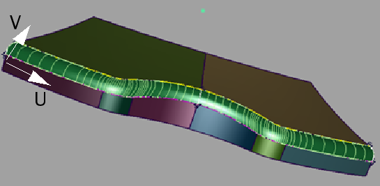

Blend surfaces are built between the primary surfaces.
Since the input curves have construction history, modifying them also updates the transitional surfaces.
