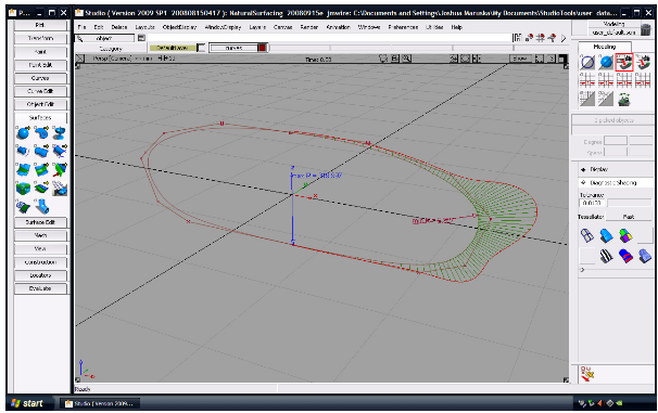

The easiest way to establish the core component will be with a revolved surface; and that starts with a curve.
The curve shown here has as few CV's as will allow to create the shape I want. Being conservative with CV's will be a common theme throughout the demo. The reason for this is that surfaces, like curves, use CV's to define their shape and the more CV's there are, the more chance for lumps or flats there are. I can be very meticulous about my CV placement and will often build a model several times to find ways of getting that CV count down.
This curve has 3 CV's at the start that let me define the top crown, 3 CV's at the end define the bottom crown and two at the perimeter that allow me to control the peak radius at the edge. I should also mention that this is a 5th degree curve. I find them the easiest to work with for this type of modeling exercise. They stay smoother than 3rd degree curves and are more responsive than 7th degree curves.
Incidentally, the minimum radius that is shown in the curvature plot is close to what I know will be the final thickness of the watch's strap. It's never too early to plan ahead.

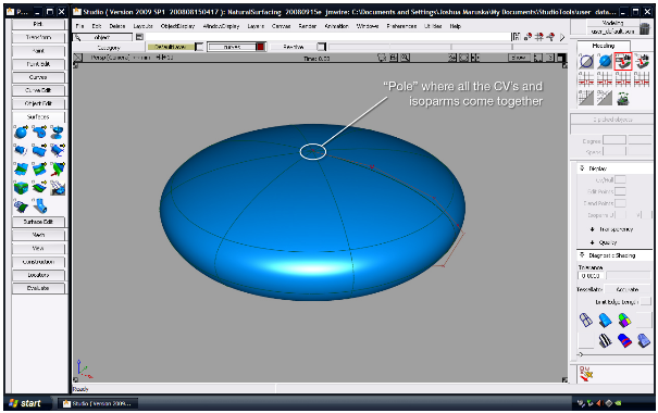

The Revolve
The biggest challenge when working with revolved surfaces and spheres is the "pole". This is where all the CV's and isoparms come together. If you've ever picked apart one of these surfaces, you'll know that the poles are a nasty dirty mess. There are many things all piled on top of on another.
The problem with poles are that trying to extract surface direction from them can be difficult. The UV directions are heading everywhere and nowhere at the same time which will give tools like Align or Blend Curves nightmares in trying to resolve the situation. I'll go to great lengths to not have to deal with this type of thing.

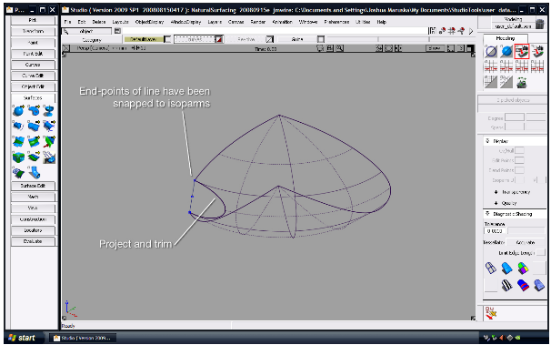

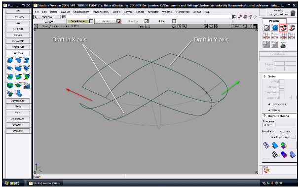

Drafting 'Stub' Surfaces
I often make little temporary surfaces to build from. I'm not sure if they have a proper name, but I call them stub surfaces. Usually they get deleted after they serve their purpose.
These particular surfaces will be used as guides to build what will become the main body of the watch or 'Master' surface. They were created using the Draft tool (one of my favorite tools) in each the X and Y directions. Notice how the isoparms of the Draft surfaces match the isoparms of the reference revolve.

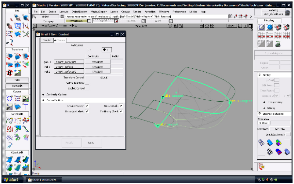

Creating the Master Surface
Here I create the start of the Master Surface using the Birail tool. The generation curve references the edge of the stub surface created from the untrimmed edge of the revolve. The rails reference the other two edges with one span each.
Again, notice that (as long as 'rebuilds' are off in the Birail tool) the edges of our new surface reflect the span structure (and thus CV placement) of the stub surfaces which in turn have inherited their structure of the revolved surface.
So why this step? Well, we've effectively built a surface that has much of the character of the revolve, but minus that nasty pole. As a bonus, we now have a surface that is 5th degree in both U and V directions - as opposed to the revolve that would have been 5th degree in one (based on our input curve) and 3rd degree in the other (which is just the way a revolve is built).
The ultimate goal, however, is for the Master Surface to hug the revolve as closely as possible. Let me note though, that while using the trimmed edge on the revolve (i.e. 2 gens and 2 rails) may have resulted in a tighter surface, building from a trimmed edge will always interject extra isoparms into the newly constructed surface. The point being is that I am trying to get the CV placement and structure in place before I worry about form. This is just the beginning...

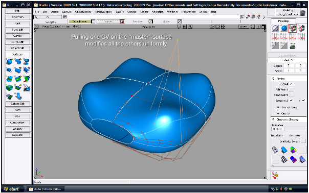

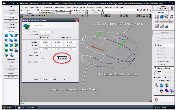

Quad Symmetry
AliasStudio has some nice two-way symmetry tools in the Layer Symmetry option. Just put some geometry on a layer, turn symmetry on and you have a 'live' mirrored reference. Any changes you make to one side, are made to the other. But what about 4-way symmetry (or more)?
Fortunately we can use 'instances' to achieve a similar effect.
Here, I've started with my railed Master Surface and then using the Duplicate Object Options, I enter -1 in the X scale parameter (to get the mirror) and change 'Copy' to 'Instance'. An instance is like a virtual copy. You can't modify the instance, but you can modify the original from whence it came- thus aping the 'live' effect that Layer Symmetry offers.
In this particular case, I've combined an instance with the layer symmetry to get 4-way symmetry. There is only one surface in this scene that can actually be modified, but all four quadrants will change when it's tweaked.
Quad Symmetry Example
Here is an example of the previous concept in action. I've tugged on one CV and all four surfaces have been modified. This set-up allows a lot more flexibility in the way I work and reduces errors resulting from not seeing the mirrored half of an object and losing tangency as a result.

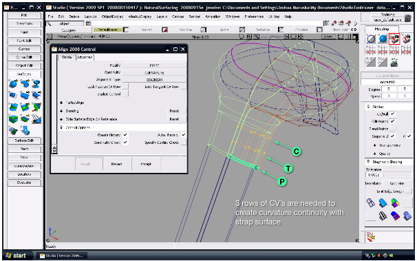

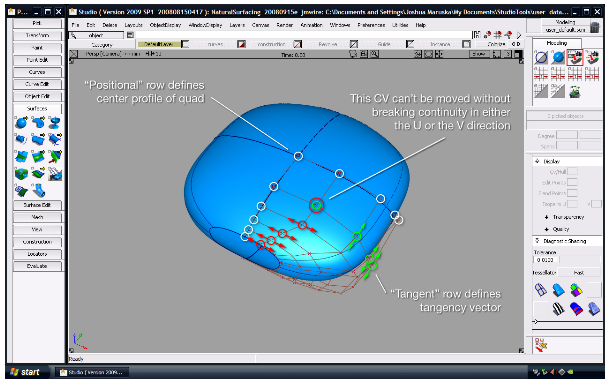

A CV Primer
Before we start modifying our shape, I wanted to establish some ground rules for manipulating CV's on a surface.
I like to think about CV layouts in terms of rows. The CV's that exist at the edge of a surface define that surface's edge profile. If the CV's are in a straight line, the surface's edge will be a straight line. This is the 'Positional Row'.
The next row in, the second row of CV's, are the 'Tangential Row'. This row defines the 'vector' at which the surface terminates. If all these CV's are aligned in a horizontal plane relative to the 'Positional Row' then your surface will be tangent to a horizontal plane adjacent to the surface's edge.
These two rows are well within a human's ability to control manually. The next row in, the third row of CV's, are the 'Curvature Row'. Without getting into a whole discussion about 'what is curvature continuity', we'll just say, in most situations, it's improbable and impractical that anyone would model two adjacent surfaces to curvature continuity without the aide of computer control. The math is just too great.
There are two situations where this isn't true. The first is; that to be curvature continuous with a flat plane requires that the first three rows of CV's be in that same plane. The second is when dealing with symmetry. By definition, a surface mirrored about it's edge will be curvature continuous to itself along that edge (assuming the edge was at least perpendicular to the plane of reflection). It may not be pretty, but it will be mathematically correct.

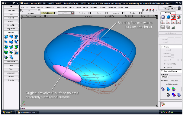

Using an Underlay

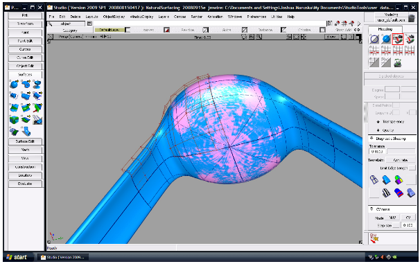

Let's start sculpting. I've brought back the original revolve in it's entirety. We will be using it as a guide to help us shape the Master Surface. To facilitate this, I've colored the revolve a different color than the Master Surface. You will immediately notice that the revolve shows through in areas, but in a fuzzy, noisy kind of way.
This is an artifact of shading in 3D programs. It's probably a bug, but I've never seen any 3D software that doesn't do this, so I've taken to using it as a feature.
The premise is simple, when two surfaces have nearly the same topology, the computer can't decide which one to bring to the forefront to shade first, so it shades them both and makes this noisy pattern. In this case, this is how we'll know when our Master Surface is approaching the right shape. We see the noise at the edges of each quad because they currently use the same CV placement at those edges. The rest of the surfaces are quite different from one another so we don't see anything other than the front most/outer surface.

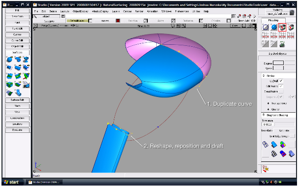

Placing the Strap
Before we get too carried away with tweaking the shape of the Master Surface to match the revolve underlay, we have to do a couple of things first that will make our situation worse before we can make it better.
I've placed the start of the wrist strap in the model. It's placement in 3D space is based on an ellipse that represents a person's wrist. I use a 60 mm x 40 mm ellipse. The strap is placed tangent to that ellipse so that the straps extend out at about 30° from vertical. This will vary on your design and manufacturing method.
The profile of the strap is built from a duplicate curve that has been copied off of the original revolve. This is important since we want our number of CV's and spans to be identical to the Master Surface.

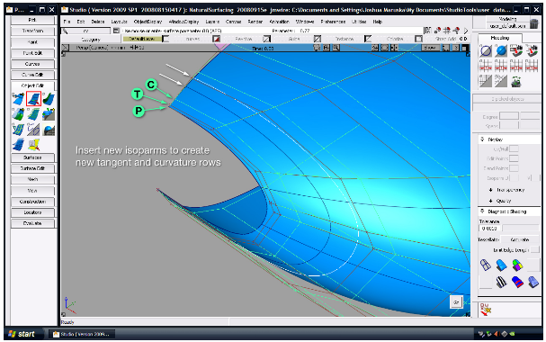

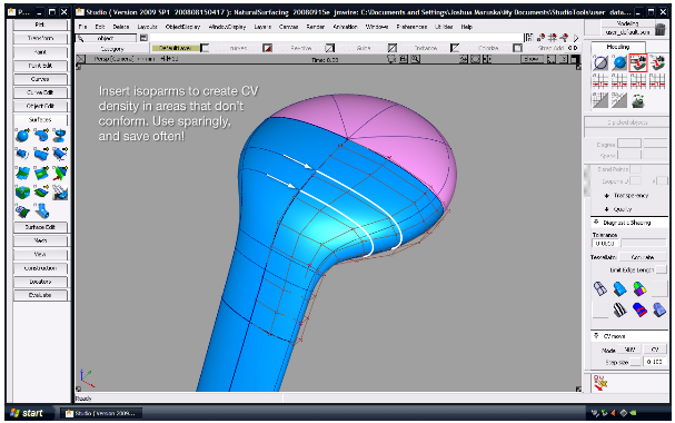

Insert Isoparms
If we were to just align the Master Surface to the strap at this point, most of our CV's that define the median profile would be swallowed-up by the alignment resulting in quite a loss of our overall shape and the need to rebuild and tweak more than necessary. Anytime you move a CV, it has 'influence' both upstream and downstream from itself. The higher the degree of the curve or surface, the more broad this influence can be.
By inserting two isoparms (Object Edit > Insert) close to the edge of the Master Surface we gain a couple new rows of CV's. We have the existing Positional row and now new Tangential and Curvature rows close to the edge we'll be aligning. We'll still lose some shape due to stretching, but much less than we would have if we had just let the original rows to become aligned with the strap.
Aligning the Strap
Next we align that edge with the new isoparms to the edge of the strap surface we made earlier and we have the start of our fluid watch shape.
The CV rows that were so close together in our previous step are now spaced far apart and make an elegant transition into the head of the watch. While we still have construction history for the alignment, we can move the CV's around. They will snap back to the next closest position in space that still meets the requirement of the align, so if your CV's are too close or too far, a quick manual adjustment will get them looking right.
As an aside, I find that the "Align 2008" works better for this type of modeling approach, where as the new Align tool in AliasStudio 2009 works great on trimmed surface edges.

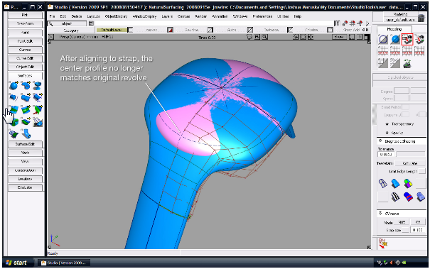

Align Result
Before we start tweaking, I wanted to show what the surfaces look like after the strap transition alignment.
In earlier stages, the median profile was much closer to the underlay and now it is very different. We could have added more isoparms to the surface prior to the align, but that would have also meant more CV's for us to deal with, so in the interest of CV conservation, I didn't add any more isoparms than I needed at that point.

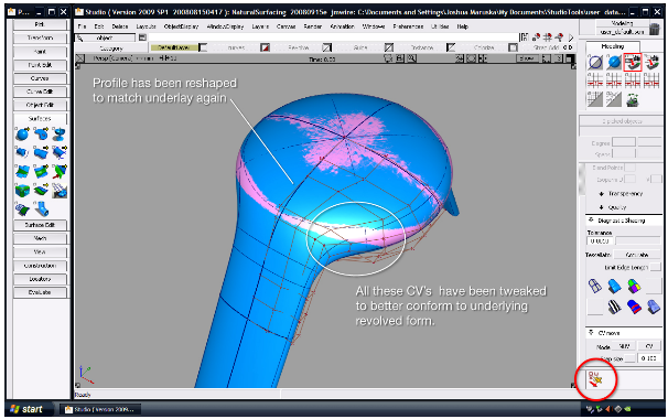

First Tweak
After giving the CV's a good tweaking, our shape is much closer to the revolve than ever.
I wish I could show you every step along the way, but each CV move is subtle. I tried to capture the development of this project at stages when there is something to show or before I do something drastic.
I also wish there was a specific 'this or that' I could share in regards to actually moving the CV's, but it really comes down to practice and patience. This is not a terribly fast method of sculpting. Well, I take that back - it can be - in fact I sketch this way quite often, but for final, production-ready appearance surfaces, it's tedious at best. It is an art form of sorts.
Generally though, here are some tips. The CV Move Tool (at the bottom of the control panel) has three modes, NUV, XYZ and "Slide". XYZ functions like the regular Move Tool under the Transform menu and moves CV's along any of the world space axes. NUV moves CV's either along the surface or perpendicular to it. Lastly is "Slide". This last mode adds a little move widget to selected CV's which allows you to move the CV along it's connected 'hull'. This is great for moving Tangential Row CV's when you don't want to break their tangent vector. For all the other CV's, I usually use the NUV and XYZ modes.
Keep in mind that position of the tangent row CV's and how they need to stay in the same plane as the Positional row.

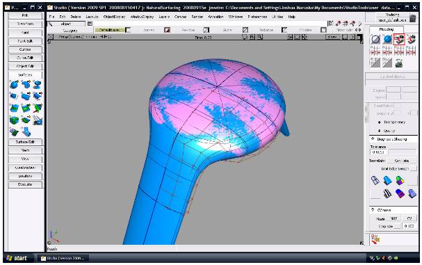

More Tweaking
We are getting closer now. The shading noise is becoming more diffuse and uniform. We are also seeing the polar pattern of the revolve show through the Cartesian pattern of the Master Surface.

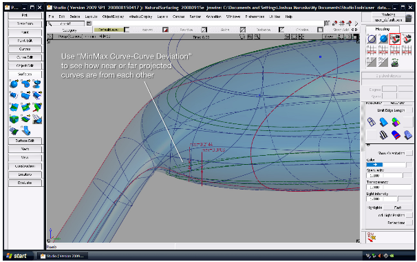

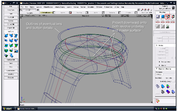

Project Reference Curves
Often times, a visual inspection of the surface won't be enough. In this case, I plan to have some elements of the design that will need to perfectly mate together.
I am assuming that this watch will have a ground glass lens. Because of the way watch crystals are made, the lens will have to be a perfect revolved section. Fortunately, we started with one of those. But how can I be sure the Master Surface and the revolved section will meet perfectly at the adjacent edge?
By projecting a line (in this case a circle - or two) onto both, I now have a common reference point by which to judge.

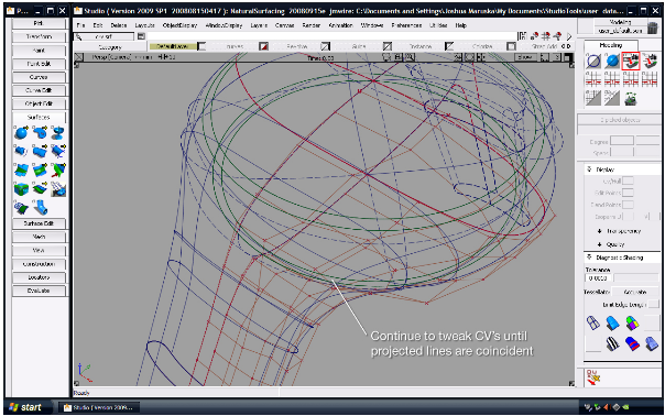

Deviation Measurement
With both the revolve and Master Surface sporting projected Curves on Surface, I can now add a deviation measurement using "MinMax Curve-Curve Deviation" in the Locators palette.
I can see that one of my circles is off by only 0.0766 mm but the other is off by 0.2144 mm. I would prefer to have these values below 0.01 mm - a value that will be far below the manufacturing tolerance of the parts.
We still have some work to do.
Tweak Result
With some additional work, our projected curves are within acceptable tolerance of each other.
Again, there is no magic trick, just persistence. One of the things that I try to do while CV tweaking is to maintain uniformity of each of my rows - both along the U and the V of the surface. I generally don't make huge adjustments to just one CV, but rather 'creep-up' on the desired form by moving each CV just a bit. I usually find working in a radial pattern out from the most misaligned portions a good approach. This prevents the tendency to over-adjust one CV and then over-compensate with CV's surrounding it.
Think of the array of CV's around your object like a cage that floats just off the surface. This cage really defines your shape and there fore shouldn't be much different.
Lastly, and most importantly, save often. Save iterations. Definitely save before you insert a new isoparm. I will sometimes have dozens of files that have each been incrementally saved as I go.

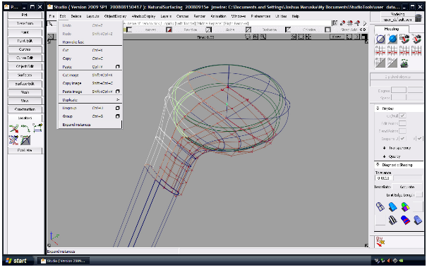

Expand Instances
Every good story has at least one good twist. This one will have a few.
Using "Expand Instances" will convert the selected instance from a virtual copy into real geometry. With this relationship broken, any changes I make to one side, will no longer be reflected in the other.
I have also turned-off the layer symmetry option.

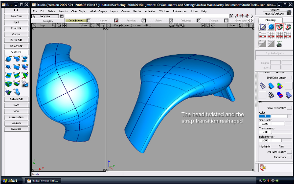

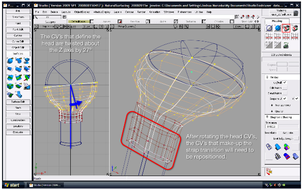

The Twist in the Story
So far we have been working with geometry that mirrors itself across multiple axes. This has kept the demonstration fairly straight-forward and digestible, I hope. But in the interest of creating a truly dynamic and fluid shape, we are going to give this product a bit of that "hurricane" aesthetic common to sport watches.
Here, I grab the CV's that make-up the majority of the watch's head and rotate them about the Z axis. In case you were wondering, the head in the final model is rotated 27 degrees. I did this by typing the values 0,0,27 after selecting the rotate tool. Be sure to be set to 'relative' mode or CV's will move in unexpected ways.
I will then grab the remaining CV's and twist them over and downward to smooth out the strap transition again. Think about you CV's in blocks or masses. The three rows of CV's at the end of the strap would be good example of CV's that should be moved as one 'unit'. The head CV's are another.
Twisted Result
Boom. That's quite a bit different from where we started from. It's still pretty rough, but in the next part this series we'll be looking at a variety of techniques to continue tightening-up the model.
