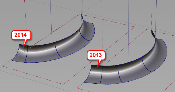

We have improved the calculation of surface fillet extensions when Flow Control is set to Extend (at the start or end of the fillet). The new extensions follow the shape of the fillet in a more natural manner. In previous releases, extensions were linear (straight).
Comparison of a surface fillet extension in Alias 2014 versus 2013.
