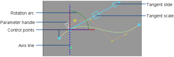

Use the manipulator to reshape the curve or surface
Click a control point to display the manipulator on it, then do any of the following:
- Drag the control point to move that point in space.
- Drag the parameter handle to move the control point along the object.
- Drag a dotted rotation arc to rotate the control point’s tangent direction.
- Click one of the axis lines to snap the tangent direction to an axis.
- Drag the tangent slide handle to move the control point along its current tangent line.
- Drag the tangent scale handle to scale the tangent at the current point. You cannot snap the tangent scale handle.
- Click any of the handles and type exact values.
- Use the U+/U- and V+/V- buttons (for surfaces) and the -Influence/+Influence buttons (for curves) to increase or decrease the number of CVs influenced by the control point (in both U and V directions for surfaces).
