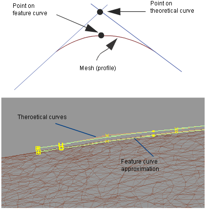

The output consists of a theoretical curve, and, if using the point method, a feature curve approximation. The feature curve attempts to lie on the mesh as much as possible. The theoretical curve is drawn where both sides of the mesh (across the feature curve) would intersect if they were extended. The theoretical curve generally lies off the mesh.

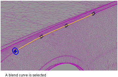

This creates a variable-radius cylinder and controls the shape of the resulting curve.

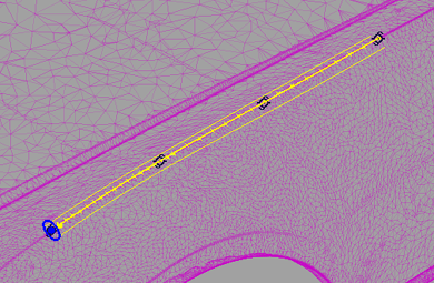

A degree 1 curve is produced: the theoretical intersection curve.
Tangent lines, drawn in yellow, show you where the tube intersects the mesh. They help you ensure that the radius is large enough to cover the entire transition region.

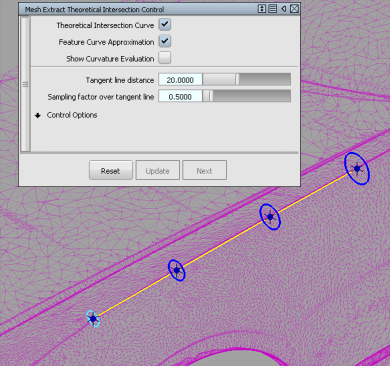

You can still add more radius manipulators or change others options in the option window then click Update to recompute.

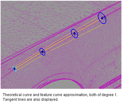

Each point appears with a blue radius manipulator and a cross in the middle. The cross can be selected to reposition the manipulator inside the feature.
An approximation feature curve is produced in addition to a theoretical intersection curve. Both curves have degree 1.
You can add more radius manipulators (by clicking on the feature curve) or change other options in the option window then click Update to recompute.
