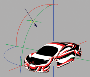

Reflection Lines (Iso-Angle)
A more accurate evaluation than the zebra stripe shading is provided by the Iso-Angle tool. This shows you the line of zero angle between the surface normals and an infinite 'light source direction'.
This is found on the Evaluate Palette where you will find additional advanced tools. Double-click to open the option window to set up the display.
