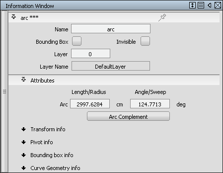

For example, a keypoint arc has edit points and CVs just like a normal curve, but it also has a radius, sweep angle, and center point, all of which can be edited. During editing, the arc stays an arc: it does not lose its shape from keypoint editing.
When you combine keypoint curves into composite curves (for example, with the Line-arc tool), relationships between the individual lines and arcs are still maintained.
Most tools that work on normal curves also work on keypoint curves.
