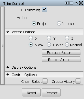

To avoid the two-stage process, the 3D Trimming option in the Trim tool allows a workflow similar to that used in ICEM. The option allows you to select the surface, the curve and the region to keep in one operation.
The direction of projection is selected through the Vector options, just as with the Project tool.
