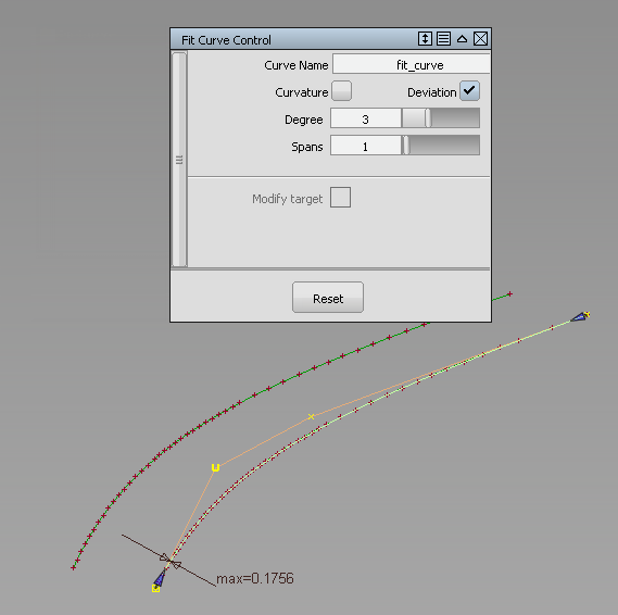

  1. Choose Curve Edit > Fit Curve.
    The control window opens automatically.
  2. Click the scan line (section data).
    A NURBS curve is fit to the section data.
  3. Do any of the following:
    • Drag the start and end point manipulator arrows to control which part of the scan line the curve is fit to. Usually you will want to fit curves to sections with little curvature.
      When dragging the arrow manipulators on a fitted curve, snappable points appear automatically (without having to hold any control keys).
      Light blue segments indicate snap divisions (equally spaced along the fitted curve).
      Pink crosses indicate locations where the fitted curve intersects other curves or surfaces in the current view.

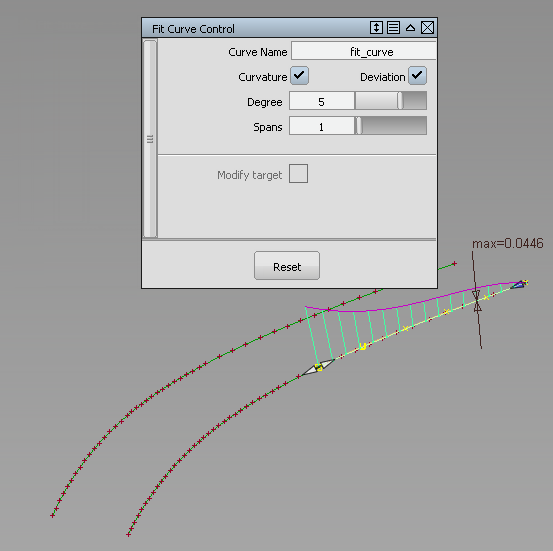

    • Turn on the Curvature option to show a curvature comb plot on the new curve.
    • Turn on the Deviation option to show the maximum deviation between the new curve and the scan line.
    • Adjust the Degree and Spans settings in the Fit Curve control window to try to achieve a better fit. Increasing these values will make the curve fit the scan line better, but will also give you a more complex curve.
