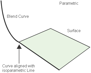

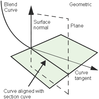

What is the difference between parametric and geometric curvature?
Parametric curvature: align the curvature to the isoparametric direction of the surface. This type of curvature is especially useful to achieve curvature continuity with the corner of a surface.
Geometric curvature: align the curvature to the intersection of the tangent and the normal direction of the surface.
Note:
You must use geometric curvature if you want the blend curve to be planar (all points on the curve lie in the same plane).
