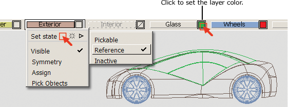

Layer Tab Menu
Each Layer tab has a sub-menu for assigning objects and turning the layer visibility on and off. The Set state sub-menu puts geometry into the background, visible but not pickable:
Pickable:
normal working state.
Reference:
geometry can be snapped to, but not selected.
Inactive:
not selectable
