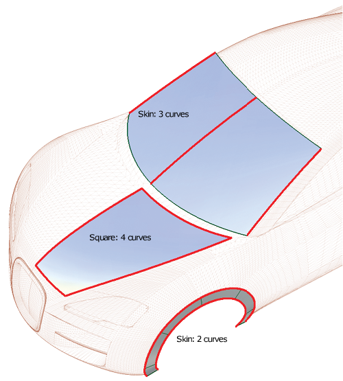

Surface from Curves
The Skin tool creates a simple straight-line surface between two chosen curves, or a multi-span smooth surface through multiple curves.
The Square tool requires four curves, and they must be coincident (touching) at the corners.
