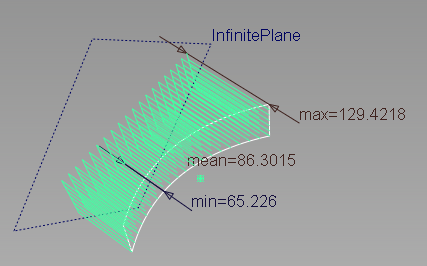

Add a deviation comb plot between two objects
- Choose the appropriate tool for the object types you want to compare:
- Select the two objects. You must select the objects in the order specified by the tool name. For example, in Curve to Surface deviation, select a curve, followed by a surface. (For Object to Plane, the order does not matter.)
Tip:
Remember that for “curves” you can use surface edges, trim edges, isoparametric curves, and curves-on-surface in addition to free curves. For all tools, you can also select objects in reference layers.
The tool displays a deviation comb indicating the deviation across the length of the objects, labeling the minimum, maximum, and mean. The Mesh to Surface deviation tool only displays the minimum and maximum deviations.
- Do any of the following:
- Drag the
to change the scale of the quills.
- Drag the
to change the density of the quills.
- Drag a label to move it.
