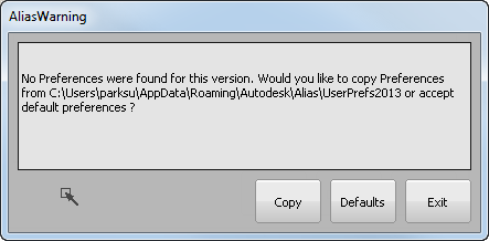

If the folder does not exist, it is created the first time Alias2014 launches. The following dialog appears:
Choose Defaults to accept the new default preferences.
