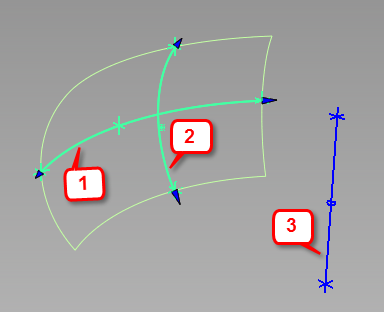

Create a section of a surface of revolution with the Surfaces > Revolve tool by specifying five points. This type of surface (called Barrel surface) is useful for modeling vehicle side windows.
To create a barrel surface, you first select three points to define an arc of revolution. You then select two more points which, along with a third point located on the first arc, define a second arc, the barrel curve. The barrel curve is revolved along the arc of revolution, using the specified axis.
1: arc of revolution; 2: barrel curve; 3: axis of revolution
