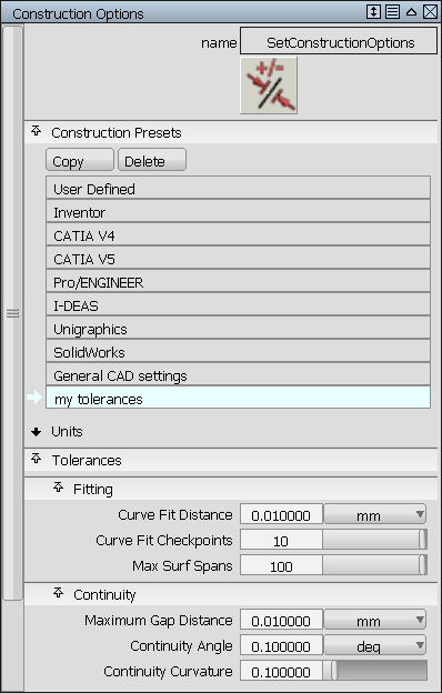

Alias differs from ICEM in that it has one master set of tolerances that it uses for all tools. These are set using PreferencesConstruction Options, which opens the construction options window:
The presets help to ensure successful data transfer into downstream CAD systems.
