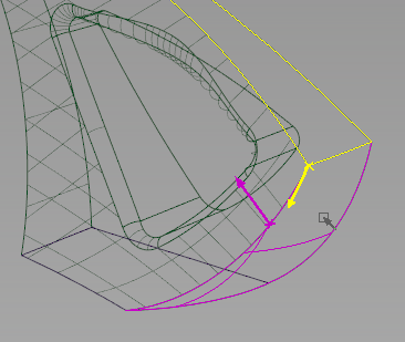

Align and trim edges
To create a transition surface between the fillet and the square, they must be aligned and trimmed.

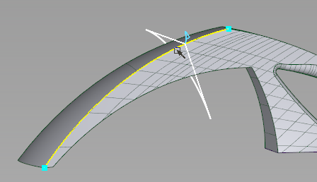

- While the fillet is still selected, click the Look At button in the NavBar to zoom into the surface.
The fillet surface extends beyond the square surface.

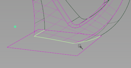

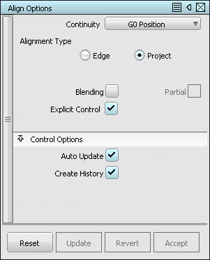

- Choose Object Edit
Align and open the options box.
- Change the Alignment Type to Project.
- Pick the edge of the surface fillet nearest to the square surface, and confirm that construction history will be removed.
In the options box under Vector Options, select Y.
- Click the interior of the square surface to set it as the master geometry.
The edge of the fillet surface aligns with the square surface, and curves-on-surface are created.
- Choose Surface Edit
Trim and pick the square surface.
- Click in the interior of the square, and Click the Keep button.

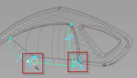

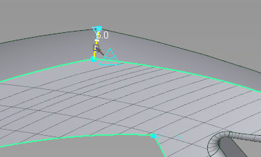

Round the edges and set corner shapes

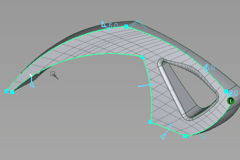

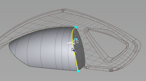

The Round tool automatically creates transition surfaces at edges and corners. This can complete the transition between the top and side surfaces

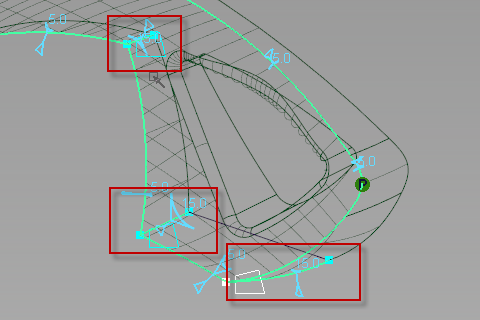

- Choose Surfaces
Round.
- Click the top edge to set a Round Radius.
A radius locator appears where you click, and the edge is set to be rounded.
- Type a value of 5 for the default radius, and press Enter.
- Continue to click all the edges around the square side, as shown in the following image.
- Click the Build button to see the transition surfaces.

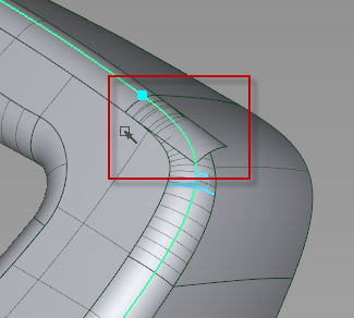

There is an error at the back corner, where a round surface is not trimming.
- Click the Revert button to return to edge selection.

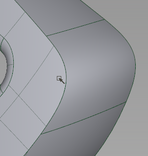

click the area to set the center of interest, then Zoom into the blue square at the back corner.
Blue squares indicate corners or tangent breaks. There is a break along this edge.
- Click to add a radius on the edge in between the two blue squares.
- Click the Build button to see if the error is resolved, then click the Revert button to return to pick more edges.
- Click to add a radius on the edge between the top surfaces.
- Type a new radius value of 15 and press Enter.
- The corner where the three edges meet has a hexagonal Corner shape manipulator next to it.
This indicates a multi-surface setback corner.
- Click the Build button to see the surfaces.
- Click the Corner shape manipulator to change it to a rectangle (single surface corner).
- Click the Build button to see the desired single surface.
- Toggle Shade (Fast) OFF to see the interior wireframe edges.
- Give the 3 remaining edges of the vacuum housing a radius of 15 each, and set their corner shapes to single surface as well.
- Click the Build button to see the desired round on all visible edges.
- Toggle Shade ON on to inspect the shape of the transition surfaces.

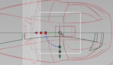

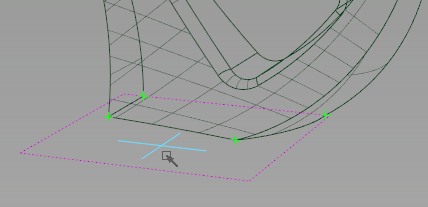

- Choose Construction
Plane.
- Click the Geom button, to align the new construction plane to scene geometry.
- Click-drag the top surface until the center of the plane is centered on the sketch switch.
Note: The orientation of construction planes varies with the geometry you align to. If the plane is not as shown above, click the black square manipulators to set the plane to the right axis.
- Click the Set Construction Plane button. The coordinate system is set to this plane.

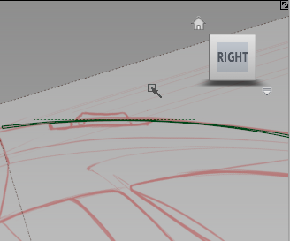

- Use the ViewCube to switch to the Right view.
You can see that the ViewCube axes are "tilted" to the active construction plane axes.
- Switch to the Top view.
Note: The sketches may appear incorrect because we are viewing them at an angle in orthographic views.

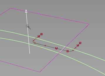

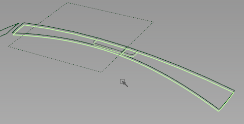

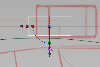

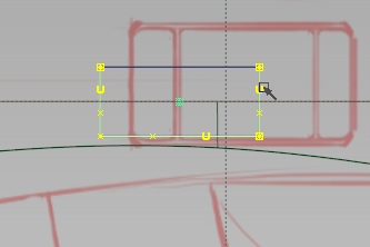

- Choose Surface
Primitive
Plane, and grid-snap the plane along the centerline until it is centered at the thinnest part of the top surface.
- Use the Scale manipulators on the plane to adjust its size to fit inside the top surface, as shown in the following image.

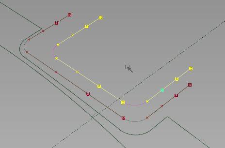

- Choose Curve Edit
Duplicate Curve, and click the three edges of the plane.
- Pick Nothing, and then Pick Object and pick the plane.
- Delete the plane.

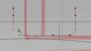

- Choose Curve Edit
Fillet Curve, and pick two intersecting curves.
- Enter a radius of 3, and click Accept.
- Add a similar Fillet Curve with a radius of 3 in the opposite corner.
- Pick Object, and pick all 5 curve segments.
- Switch to the Perspective view, and see that they are drawn directly on the construction plane.

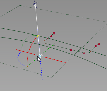

Vector.

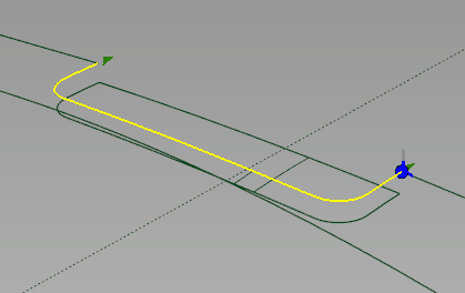

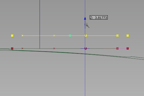

-click to start the vector on the construction plane.
- Click the blue vector line to set the vector perpendicular to the construction plane.

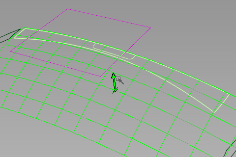

Project, and pick the top surface to project onto.
- Click the vector to set the projection direction.
- Click Go, and pick the 5 filleted curve segments.
- Click Project.

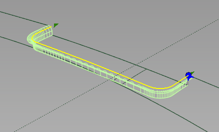

- Choose Surfaces
Rolled Edge

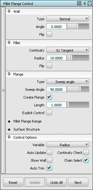

Fillet Flange and open the options.
- In the Fillet Flange Control option box, check on Auto Trim and Chain Select.
- Set the Fillet Radius to 1, and the Flange Length to 1.
- Zoom into the switch location on the top surface, and pick the trim edge.
- Check the direction of the flange and fillet. If pointed up, check the Fillet Flange Wall option to Flip.
- Click Update to build the fillet flange.

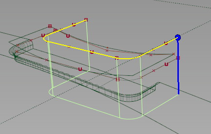

Create the switch curves and surfaces

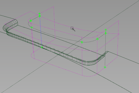

Some objects from the previous step can be copied and modified with history to create the shape of the switch inside the embossed region.
- Make the switchcurves layer visible and active, and hide the switchsurfaces layer.

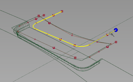

- Pick Curves and select the 5 curves of the switch profile.
- Copy and Paste duplicates into the scene.

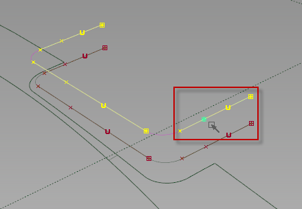

-click the fillet curves in each corner to unpick them. A pick chooser appears with the copied fillet checked in the list.

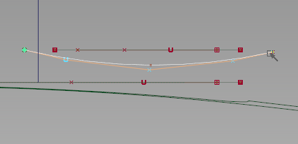

- In the Right view, Move the remaining 3 copied curves using the
The fillets move with them.

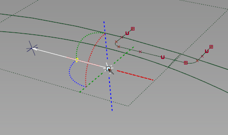

- Choose Transform
Local
Set Pivot and magnet snap the pivot to a CV on the selected curve near the back.
- Choose Transform
Non-proportional Scale.
- Enter values of 0.7, 1, 1 (with commas) and press Return, to scale the curves by 70% in the X direction, and maintain 100% in the Y and Z directions.
Note: If the active construction plane has different axes from what is shown in the tutorial, the order of these values (X, Y, Z axis, respectively) may change.
Again, the curve segments adjust to these dimensions, but the fillet curves retain their radii.

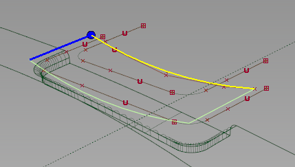

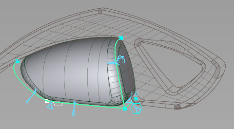

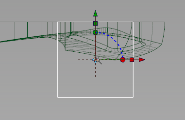

- Choose Curves

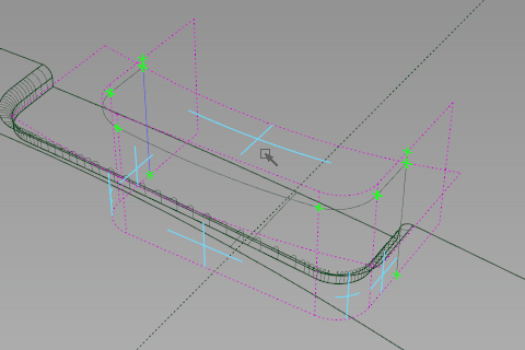

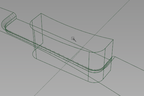

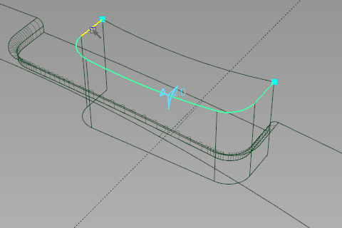

New Edit Point Curve, and in the Right view, draw an arc between the copied curves and the originals.
This becomes the top of the switch button.

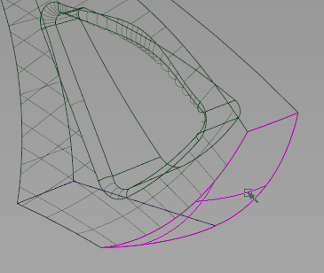

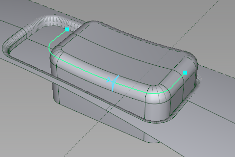

- Make the switchsurfaces layer visible and active.
- Choose Surfaces
Multi-surface Draft and open the option box.
- In the Multi-surface Draft option box, under Pick Mask, uncheck all components except Curves.
- Pick the curved profile as the input curve, and set the Draft Vector to be Y and length to be 12.
- Click Update to build the draft.
Note: If needed, check the Flip option to keep the draft on the modeling side of the symmetric plane.
- Click the Next button in the option box.
- In the Control option box, check Chain Select.
- Pick the copied profile curves.
- Click the construction vector to set the draft direction.
- In the Multi-surface Draft option box, set the Length to be long enough to intersect the embossed area.
- Click Update to build the second draft.
