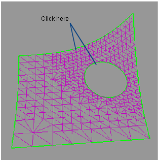

  1. Choose Mesh > Mesh Curves > Mesh Boundaries.
  2. Select a mesh
    All the mesh boundaries are highlighted in green.
  3. Do one of the following:
    • Click on the boundary or boundaries you want to extract (they turn yellow), then press the Extract button at the bottom of the window.
    • Press the Extract All button at the bottom of the window to extract all boundaries.

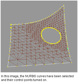

    One or more degree 1 NURBS curves are created and overlap the boundaries of the mesh.
