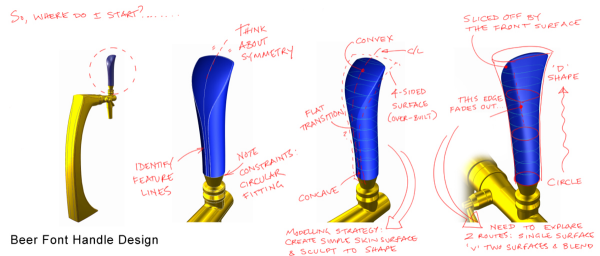

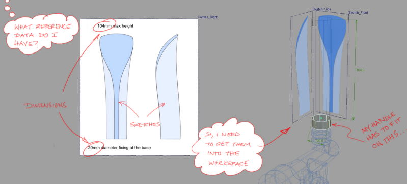

Step 1 : Just get started in 3D
I start with the easy bits. Even if it's just an outline block, or some underlay sketches. I'm always in a bit of a panic at the start of a complex job, thinking that I may not be able to model it, and so just getting started calms me down. I also find that starting to work in 3D space on the screen seems to kick off my 3D modelling brain, and I start to see how the surfaces could come together.
Then I start to try to guess what patch layout might work. Again, I look for the easy things : symmetry, feature lines, 4-sided patches.

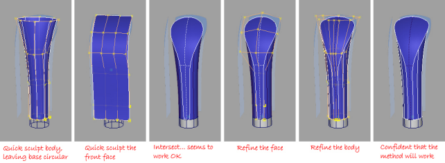

Then I start to experiment. I will work quickly and roughly, and what I am exploring is the patch layout. Its a problem-solving exercise, not really a sculpting one. All of the geometry that I create in the next few hours will probably get thrown away. And this is really important. One of the big mistakes that less experienced user make is to hang on to a piece of geometry and keep trying to make it work. Just because you've spent 3 hours trying to get a bi-rail to work, doesn't mean you should spend another 3 hours failing some more. Throw it away and try a different approach (in fact you should have done that 2 hours ago).

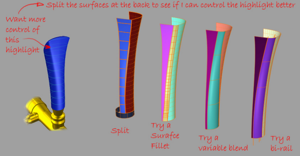

I have a habit of direct modelling surfaces by sculpting CVs, but building curves and using surface tools is equally valid and more appropriate in many cases. Here I've quickly tested out my first guess at a modelling strategy:
What I'm left with is an understanding of how the model will work as a patch layout, and some rough surfaces (which I'll probably throw away). This 3D understanding shouldn't be underestimated. After all, the design may go through many iterations before it is signed off. That understanding will be much more useful each time you have to re-build or modify your model than any particular surface.

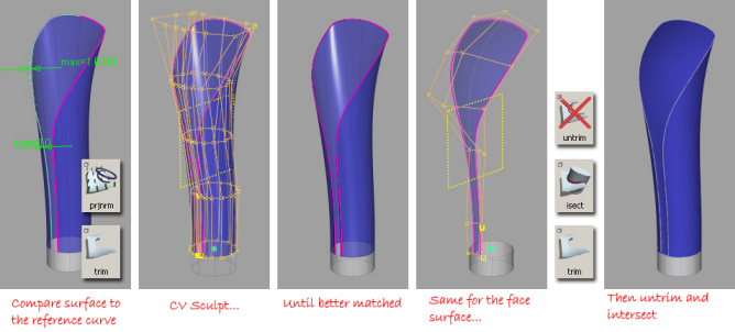

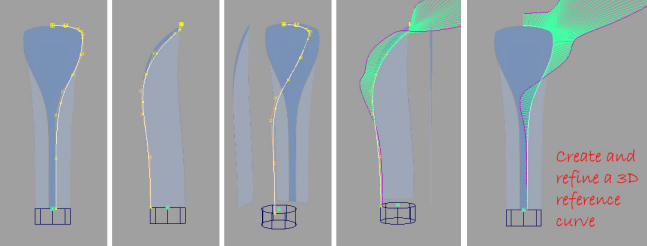

In the case of my handle, I learnt that the intersecting the two shapes gave me the design I wanted, but that it was tricky to get exactly the right intersection line just by pushing and pulling CVs. So I decided that I needed a 3D reference curve to help me get an accurate surface.
Step 3 : Sculpting
Now, I can start to craft my surfaces into the accurate shapes that I want. I will spend much longer on each curve and surface, as I now have a high level of confidence that they will be part of the final model.
For my handle, I worked on each surface separately, using the 3D curve to trim them rather than doing an intersection. I find this easier, as I only have one thing changing at a time. If I try to get the intersection right with two surfaces, then I'm never sure which one to change.

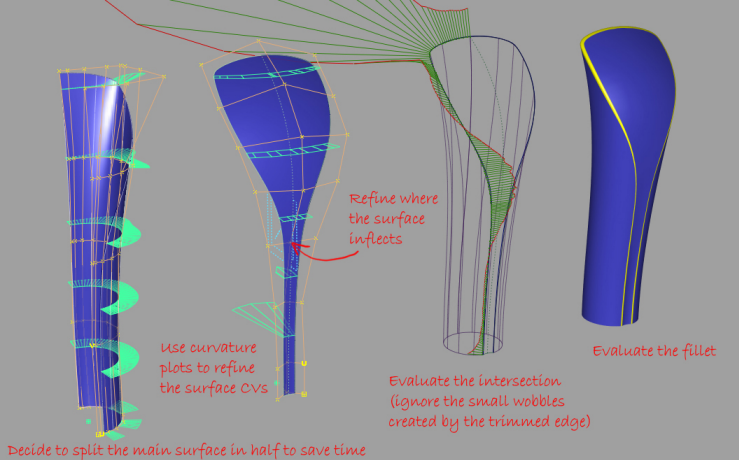

So here are some of my 'flips' between problem-solving and sculpting:
Here I'm taking time to refine the surfaces to try to get to a finished model.

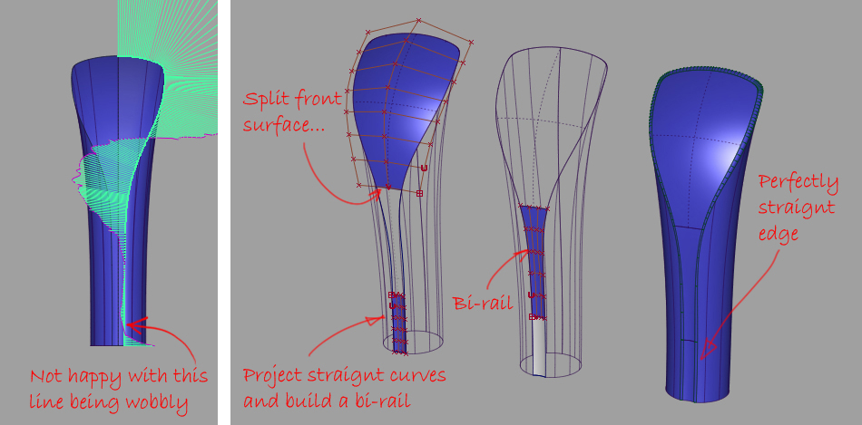

Nearly there, but I don't feel fully in control of the highlight at the back. So I switch to problem-solving mode and explore whether I should be splitting the rear surface into two, and using a fillet or blend surface.
But actually, I discover that it's more difficult to control, so I reject the idea - but I wouldn't have known that if I hadn't tried! So now I have more confidence that my patch layout is right, I just need to add some more CVs and spend more time sculpting and refining.
Finally, I'm not happy with the slight wobble at the front, so after a bit more problem solving, I end up with my final patch layout.
