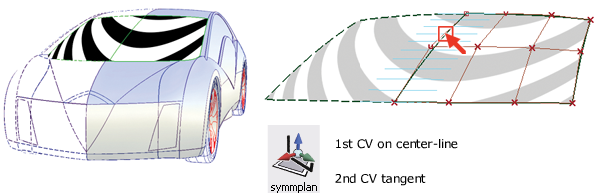

To view a mirror-image of the geometry on a layer (shown with dotted lines), use Symmetry on the layer tab. The mirror direction defaults to car-line; to change it, use LayersSymmetrySet Plane.
If symmetry is set up for a layer then Object EditAlignSymmetry Plane Align can be used to ensure tangency along the center-line edge of the geometry.
