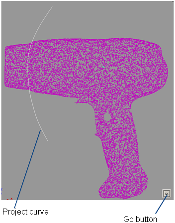

  1. Do one of the following:
  2. Select:
    • the curve(s) you want to project, in the view window that is perpendicular to the projection direction OR
    • a projection vector, then the curve(s) you want to project. See Create or edit a reference vector.

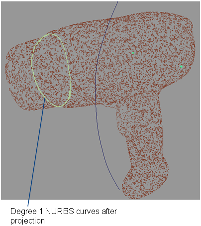

  3. Press the Go button in the lower right hand corner.
    Degree 1 NURBS curves are created on the mesh(es). They update if the input curve is modified.
    Note:
    These projected curves are often referred to as curves-on-mesh.
