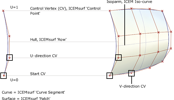

To show the terminology Alias uses, here is an example of a single-span Degree 3 (order 4) curve and surface.
Curve = ICEMsurf 'Curve Segment'
Surface = ICEMsurf 'Patch'
