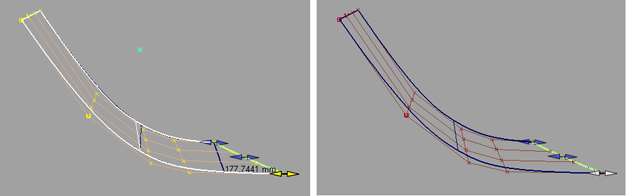

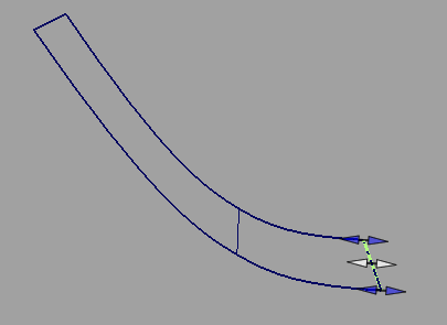

A double arrowhead manipulator (for curves) or thick green border with three double arrowhead manipulators (for surfaces) indicates which end or edge will be extended.
You can select and extend several curves, curves-on-surface or edges simultaneously. The only restriction is that all selected objects must be of the same type.
Both ends must be extended in the same direction, either positive or negative. A label shows the extension distance while you’re dragging. The controls are turned on until you exit the tool.
You can only extend periodic surfaces proportionally (one manipulator).

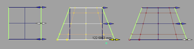

If using the Extrapolate type with Merge on, you can select two opposite edges of a surface and symmetrically extend both at the same time, as shown below.
In all other cases, you can only use non-proportional Extend when a single edge is selected. Consequently it will not work when Chain Select is on and several tangent continuous edges are selected automatically.
