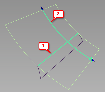

Create a section of a surface of revolution with the Surfaces > Revolve tool by specifying a curve, and two points that define an arc of revolution. This type of surface (called Helix surface) is useful for modeling vehicle side windows.
To create a Helix surface, you select one or more curves, to be revolved around the specified axis. You then select two points which, along with a point on the (first) curve, define an arc of revolution. You can then adjust the Pitch option to move the curves up or down as they revolve, creating a spiral effect.
1: input curve; 2: arc of revolution. Axis of revolution is off screen, on the upper right.

  5. Select two points to specify the ends of the arc of revolution. A third point located on the first curve is used to define the arc.
    • The arc is drawn as a green line with arrow manipulators on both ends. If you do not see the arc, change the axis of revolution in the control window. The axis cannot be in the same plane as the arc of revolution.
