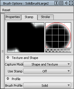

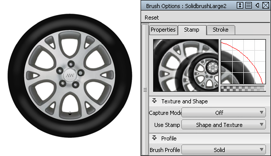

  8. Open the Brush Options window and select the Stamp tab. Select the Shape and Texture option from the Capture Mode pop-up menu.
  9. The brush cursor changes to a camera within the radius circle, and the prompt line request you to select the texture region. Note you can change the radius using the standard modifier key R. The moment you click on the canvas, the texture is grabbed from the current image layer and loaded into the brush stamp. Note how the brush stamp and brush stroke preview refresh in the brush editor to show the stamp selection.

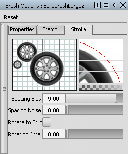

  10. Try a few sample strokes on the image layer to test the brush effect. You may need to modify the distance between each stroke by adjusting the Brush Stroke > Spacing Bias and the Brush Profile, depending upon the texture style and personal preference.
You have now created a texture brush that will create wheel stamps with transparent spoke holes.
